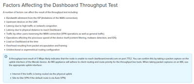

i'm just wondering how dashboard throughput works.
This is from the docs:
So for example if you have Auto VPN and a default route, the test just doesn't go through your Uplink, it goes to your Concentrator.
While the actual dashboard communication is always the uplink, ignoring routing settings.
So why does the test test something different?

I don't believe this is the case, but I can't find a link that states it.
I believe that even with a default route in AutoVPN mode, all traffic to the Meraki cloud, including speed test traffic, goes via the local management IP address and the local connection, and not inside the AutoVPN tunnel.  It is a special exception, so that management access to the Meraki device will not be cut off if AutoVPN is down.

In our setup, having full tunnel and only specific routes, the throughput test worked fine.
After adding a VPN enabled default route, the test stopped working because its put into the VPN.

And thats confusing.
There might be cases where the dashboard is not reachable from within AutoVPN, so the test will fail (or showing 0 Mbit) while the device is connected to the dashboard.
Maybe it should allow to select the interface to run the test, ignoring the routes.

It will time out in that case, I have had it happen a number of times.  I agree it should use the same route as the management traffic.
