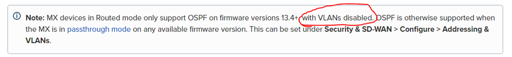

You can configure OSPF in either routed or concentrator mode, but you must have VLANs disabled.
https://documentation.meraki.com/MX/Site-to-site_VPN/Using_OSPF_to_Advertise_Remote_VPN_Subnets

So OSPF on the MX will work the same way whether the hub is configured as a concentrator or routed (with VLANs disabled), correct? Sorry if I didn't phrase my question correctly the first time.
jdsilva
Yes, it will work the same way.
