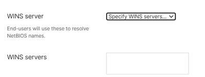

Have you tried configuring the Wins Server?

Hi and thanks for reply.
I have no problem ping netbios name of servers FQDN name when connected with VPN.
In the Windows VPN connection I have added the DNS-suffix.
