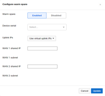

Hello cmr,
i have some doubts in step 5.
For Use MX Uplinks IPs
What i understand is i just need to add the secondary WAN in Configure warm Spare>>>WAN 1 shared IP.
And for Use Virtual IPs i can add two more WAN IPs.
So actually what is difference??
Also how can i add heatbeat to check Primary MX is down??
MX Uplink IPs
Existing MX WAN ports have an IP address from the provider that they are connected to.
New MX WAN ports need an additional IP address from each provider
Virtual uplink IPs
A floating IP address that is held by the active MX is needed from each provider
The main benefits are:
Outbound traffic always comes from this address, not one MX and then sometimes the other.
Inbound traffic to internal services can go to the virtual IP, otherwise you need to know which MX is active by using dynamic DNS or similar with the inherent delays and complexity, it can work though.
