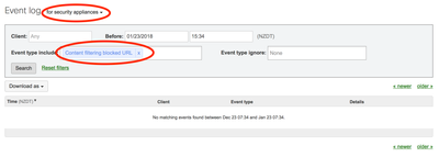

G'day I was hoping to figure out how to find out which clients are triggering the below. Is there a report that tells me which clients are doing this? This is from my Summary report for the mx84
Top blocked sites by URL
URL | ||||
Category | ||||
# Sites | ![]() | |||
% Sites | ||||
1 | geo2.ggpht.com | Malware Sites | 55 | 28.1% |
2 | crl4.digicert.com | Malware Sites | 52 | 26.5% |
3 | tpc.googlesyndication.com | Malware Sites | 34 | 17.3% |
Solved! Go to Solution.
Will the below in the event log help?

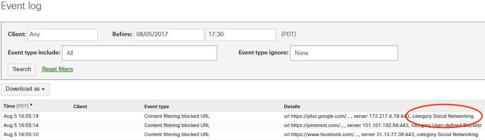

I've used this solution as well. Do you know if anyway to search by category. Combing through all of the Content Filtering events is tedious.
For example, If I have a percentage of sites being blocked by the "Adult and Pornography" filter, can I filter specifically for that category in the event log?
Thank you for your help!
@ITPointeMan If you export the log to a CSV you should be able to filter these down in Excel. The log does show the category for the blocked traffic so this will work.
