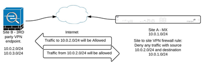

The image below demonstrates a misconfigured site-to-site firewall rule. Site-to-site firewall rules only apply to outbound traffic. This rule will never be applied as the source subnet is not a LAN subnet on the MX:

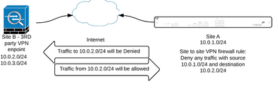

The following image demonstrates a site to site firewall rule that will be applied correctly. Traffic from the 10.0.1.0/24 subnet will not be able to reach 10.0.2.0/24 subnet since the 10.0.1.0/24 subnet is a LAN subnet on the MX.
