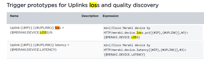

You can achieve it with Zabbix.
https://www.zabbix.com/br/integrations/meraki
