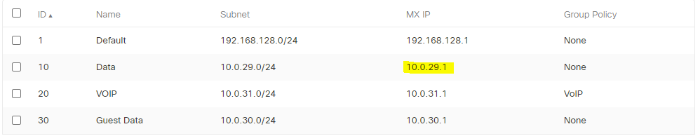

When you mean highest VLAN, do you mean the one with the smallest ID? These are mine:
The MX IP is 10.0.29.1
For the VPN config 10.0.29.0/24 and 10.40.0.0/24 (this is my VPN subnet) are configured to reach Azure.
If I am able to successfully connect from an AP using the Active Directory sign-on from Wireless > Access Control, using the DCs IPs instead of the hostname, would it be a case of the Meraki not being able to resolve the domain?

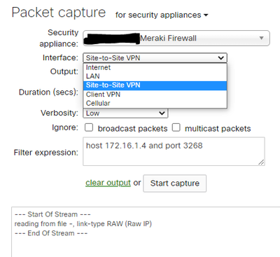

First run pcaps across the different interfaces, filtered for the target AD server IP address, to establish the source and path.

I've tried running a packet capture with the following filter expression:
dst host 172.16.1.4
This was done across:
Internet:
--- Start Of Stream ---
reading from file -, link-type EN10MB (Ethernet)
13:21:25.555820 e0:cb:bc:2f:12:cd > 8c:90:d3:03:8e:1a, ethertype IPv4 (0x0800), length 90: (tos 0x0, ttl 64, id 30251, offset 0, flags [DF], proto UDP (17), length 76)
5.252.223.106.42162 > 172.16.1.4.53: [udp sum ok] 9376+ A? cloud-meraki-asn.amp.cisco.com. (48)
0x0000: 4500 004c 762b 4000 4011 31fb 05fc df6a E..Lv+@.@.1....j
0x0010: ac10 0104 a4b2 0035 0038 9b9f 24a0 0100 .......5.8..$...
0x0020: 0001 0000 0000 0000 1063 6c6f 7564 2d6d .........cloud-m
0x0030: 6572 616b 692d 6173 6e03 616d 7005 6369 eraki-asn.amp.ci
0x0040: 7363 6f03 636f 6d00 0001 0001 sco.com.....
--- End Of Stream ---
LAN - no output
Site-Site VPN no output
Client VPN no output

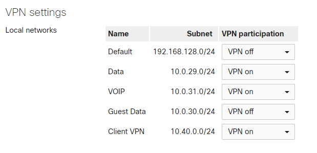

Assuming it already is, what I would do is allow all your VLANs access to the VPN, temporarily
Would be able to clarify this? Do you mean add any remaining VLANs to the address space mentioned above or here:

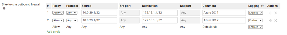

My S2S outbound firewall looks like this:

I would initially try turning VPN participation on for the Default VLAN 192.168.128.0
You'll need to add this subnet to the permitted list for the tunnel in Azure, to match.
Then run a packet capture on the Site-to-Site VPN interface of your MX, while you initiate your VPN Client session - filter for your AD server IP 172.16.1.4 if you wish.   If you see the query bound for your server, chances are it must be sourced from 192.168.128.1 (assuming this remains the IP for the MX in that subnet)
If this works, you will need to look at your VPN firewall rules, to check they still meet your needs (hint:  you have no deny rule, currently)
Done this ✔️

I've switched the authentication to Active Directory, initiated a VPN session from my client and nothing appeared whilst packet capturing on Interface = Site-Site VPN
Only results are when the Interface is set to Internet, like previously.
