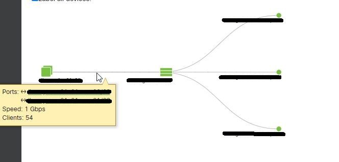

Interconnections: I have added a screenshot of the topology. Rather basic I would say. The switches in the middle are connected through stacking. The MX has two outgoing connections, one to one of the switches in the stack and another to another switch in the stack.
cmr
Thanks @Network_user55 it looks like you have an HA pair of MXs, can you please clarify, is each MX connected to two switches, or is one MX connected to one stacked switch and the other MX being connected to a separate switch in the same stack?
If the former then please disconnect one cable from each MX and try again, if the latter then that isn't the problem.

The current setup is like the former: In the stack there are three switches. Two of them are connected to the MX`s in the following manner:
1) SW1 -> MX 1 and MX 2. Both are in a forwarding state.
2) SW2 -> MX1 and MX 2. Both are in a blocking state.
So the suggestion would be to disconnect each link on (SW2 -> MX1 and MX2) ? Wouldnt that cause a lack of HA in the setup? Also, why would that cause an issue after the upgrade but not before the upgrade?

@Network_user55I'd disable the port on switch 1 for MX2 and the port on switch 2 for MX1.  That way you keep switch and MX redundancy without risking spanning tree not working when the units reboot.  I have had too many issues with reboots causing issues when double connected to risk leaving them all enabled...
It might make no difference and if your ports connecting to the MXs on the switches are set in trunk mode then you might be okay without making this change, but it's worth a try, even if you re-enable the ports after the upgrade.

@cmr  thank you, I will suggest this. The ports are set to trunk mode already but it`s worth a try.
