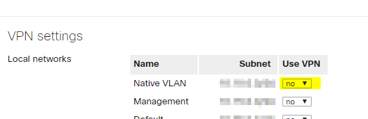

The first requirement is to have Meraki AutoVPN enabled in all your sites.
Then in Security & SD-WAN > Site-to-site VPN of the network where you have setup the static route, you will see that destination subnet listed in the Local Networks.
When you change the dropdown from "no" to "yes" for that entry, it will be announced inside the AutoVPN network. Now your other sites will be able to use the static route going through Meraki AutoVPN.

not sure I'm following.  I do use autovpn in mesh.  I am advertising the subnet for the data vlan (which is where the 3rd party inside interface sits as well)  i talk to other devices from the other site to that one (and all others) with no issue.  But i need to be able to route specific traffic out one site only the this particular location as they share the same vendor.  I've enabled advertisement of that route in vpn.  Not sure what i need to do on the other site to make sure it can use it

Let's say in one of the sites you have a static route pointing to 172.18.0.0/24 with the gateway set to 10.8.44.25.
In that list I showed you there should then be a 172.18.0.0/24 entry for that specific site. If the dropdown is set to yes, then all your sites should be able to use that route. If they have their own direct route over the local hardware it will be preferred due to the route preferences in the MX, refer to the link @ww shared.
Re: Advertising Static route in vpn
I think what threw me was you saying drop down.. I see drop downs for the subnet advertisement, but the route was just a check box on the route config page.  Thanks!
