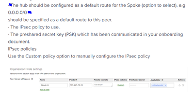

I found this information, but I have never tested It:
https://help.cloudi-fi.com/en/articles/3177550-cisco-meraki-mx-routing-tunnels-deployment
JayHylander
Just browsing
No, unfortunately that is just how to make a third party VPN tunnel on one appliance.  I'm just going to open a case with support and see what they say.
but in my understanding, in that part specifically, if you want the Spokes to reach that network you need to set the HUB as the default route. I'm going to test this here in my lab.
