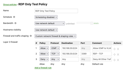

Also, here is what my resulting test Group Policy looks like:

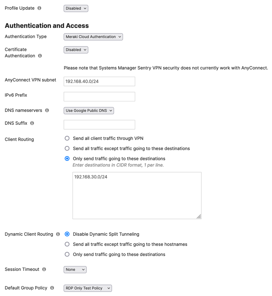

The AnyConnect configuration is set up as split-tunnel, with only the RDP subnet (...30.0/24) as an included route.

Thanks again for your detailed reply. My 'RDP only' policy was TCP only (literally TCP on 3389 and deny everything else).
I'd be interested to know what happens to your setup when you apply the policy you created as the default here (in the client VPN settings)
when i changed it there (so that all new connections have the 'RDP only' by default) I never see another new client come online. the client object is never created. Even though the VPN is connected from the client side.
Hi Charlie_C,
My apologies for not including those details. I was in fact leveraging the "Default Group Policy" feature/functionality during my testing. I'll post a screenshot of my AnyConnect test configuration below:
