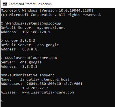

@jfuller347 when you go to a command line and type nslookup, then change the server by typing server 8.8.8.8, what do you get if you then type www.lasercutlawncare.com?

So we had changed the DNS to 1.1.1.1 and to 8.8.8.8 in Meraki>>Security & SD-WAN>>Appliance Status>>Tools>>DNS Lookup and still got the discrepancy. Unfortunately I am not behind the network or can utilize a VPN to test remotely.

That's what I get at home too. However, behind the network of the client it is not what we get.

Same here:
