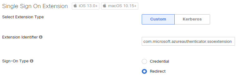

I'm trying to use the new iOS 13.0 ExtensibleSingleSignOn payload to get Office 365 URLs in Safari to SSO with Microsoft Authenticator. It's described here in the Microsoft Azure docs.
Anyway I set it all up and checked the values I had with the properties which are here in the Apple Device Management docs.

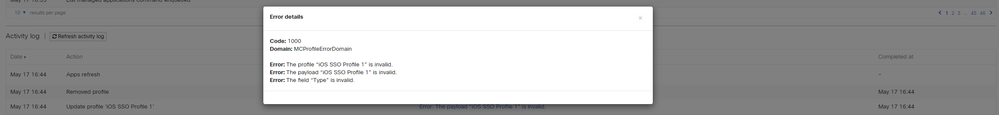

When I target devices with the profile I get the error "The field 'Type' is invalid" in Meraki (see below)
The only two type fields in the SSO payload are "Select Extension Type" and "Sign-On Type":
But because both fields are pre-defined within Meraki I'm not sure how they can be invalid. And as far as I know I can't download the payload XML to check, either.
I've checked by creating another Meraki payload using Kerberos, but that threw the same response.
