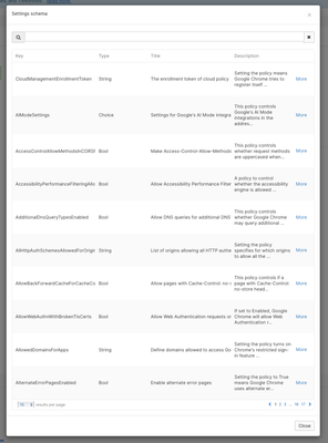

So, two things:
Managed app config on Chrome on Android is excellent. There's almost nothing you can't do. There's 170 settings that can be tweaked to get the experience you want:
 More here: https://chromeenterprise.google/intl/en_uk/policies/

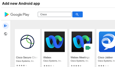

Secondly, have you considered using a Web Clip instead of a web browser?
1. Go to Systems Manager > Apps
2. Click Add App then Android, ensure that Play Store App is selected and then click Next
3. You should see a bunch of apps:

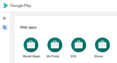

4. Click the little Globe icon, underneath the Blue Triangle
5. These are where you can create your web apps
 6. Click the + in the bottom right
7. Give it a title, a URL and decide how you want the app to work: full screen would appear to be what you need to select
8. select an icon, as necessary
9. Click Create

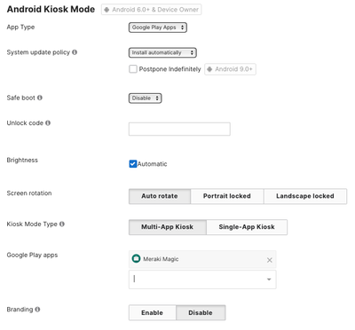

13 You can now select it as a kiosk app:
No need for third party kiosk web browsers.
