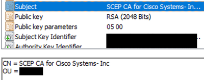

I'm having the same issue trying to update my expired SCEP certificate. I've tried using the built-in SubCA template in ADCS as well as created new templates, but I cannot seem to get the Meraki Dashboard to accept anything signed by ADCS.
Here are the basic constraints and key usage settings in my SubCA template.
Screenshot 2024-01-25 at 11.17.31 am.pngScreenshot 2024-01-25 at 11.17.39 am.png
And the resulting signed certificate from the Meraki CSR:
Has anyone been able to get this working with the newer requirements and ADCS?
