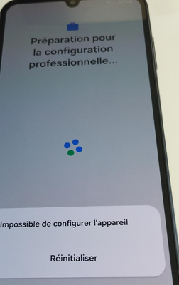

Hello,
We are no longer able to configure Android with the deployment QR code (test with two new Samsung phones of different models).
However, this one was working very well recently.
Do you have an idea please? Thanks

Hello, thank you for your response, we found the origin of the problem (wifi connection filtering)
