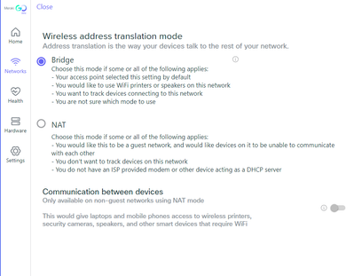

Thank you for the additional information.
Check if your Meraki Go wireless network is running on Bridge-Mode, go to Settings -> Advanced settings -> Wireless address translation mode
If you are using IPv6 make sure Wireless IPv6 bridging under "Site-wide wireless settings" is enabled.

Not sure if this still is an issue but for anyone still using Sky I got it mostly stable by creating a whole new wireless network.
Enabled Discoverable mode
Set it to NAT
Allow devices to discover each other (device to device comms set to ON) - this should turn off Guest mode
WPA 2+3
then put all the sky boxes on that wifi, it mostly held up but had its tantrums.
