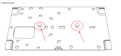

Suspended installation on a “drop-ceiling T-Rail” is not described in the installation guide and no brackets are provided. As described in the guide, it can be mounted on a vertical surface, but the GR10 mounting part is just a screw. In other words, if you forcefully use the accessories to install the AP hanging, the AP may fall. Even if you use a 3rd party product or your own work, you need to be careful not to drop it. (Its installation is an unsupported method, so drop damage is at your own risk)

Look for the Cisco Meraki MA-MNT-CLG-1 T-rail mount kit, 1st using the mounting plate for the AP mark the t-rail with a marker using two holes on the plate, then you twist this against the t-rails after loosing the allen screws with the middle hole lining up with the marks made, then tighten them down and attached to the mounting plate for the AP with the supplied screws. Use them all the time, so far have not seen any manufacture do this as well, simple, secure and fast.
