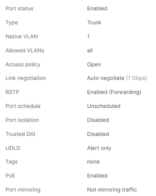

Understood. Here is the configuration of the port that connects the switch to the MX.
What about the switch? Apparently everything is ok, so I don't see any configuration problems on the MX side, even if you put a native VLAN as 21.
