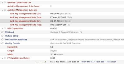

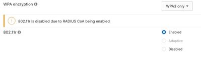

In my network (MR 31.1.5.1), I have an SSID that is configured with 802.1X and both CoA and 802.11r.
The dashboard states that 802.11r would be disabled:
And the documentation states that 802.11r gets disabled:
But in reality, 802.11r is still announced:
And Roaming is done based on 802.11r:
