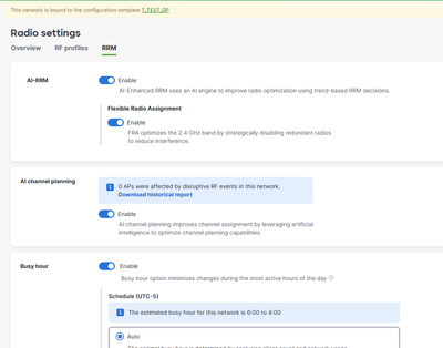

After reading and trying AI-RRM , I have a few questions :
1-AI-RRM is available as an Early Access feature in the US and EU regions. AI-RRM is not yet supported in Asia, ANZ, Japan and Canada.
I'm currently in Canada with the reg domain IC and AI-RRM & FRA seems to be working just fine. Is this statement still correct ?
2- Will auto Busy hour work with templates?
  •  No, auto Busy hour is not supported on templates.
This test network is configured with a template and busy hours are available as a local override. Is the statement about templates still acurate ?

Thank you for the documentation feedback! It looks like the AI-RRM document was modified since your post, (most recent update was on Mar 13, 2025), and it no longer indicates that Canada is not supported: https://documentation.meraki.com/MR/Radio_Settings/AI_-_RRM#How_to_enable_AI-RRM
For your second question, I have asked for further clarification on the document, and for it to be updated as needed. The wording is vague enough that I cannot tell if the intent is that the parent template cannot have AutoRF busy hour enabled (which is true, there is no AutoRF option for the template) or if the verbiage is supposed to refer to the child network instead (which as you have shown and I have verified from my own lab to contradict the answer).

I was able to confirm with our development team that they have observed unexpected behavior with AI-RMM on networks that are bound to templates.
I have reached back out to the development team in hopes for them to provide some additional details regarding the unexpected behavior and will circle back here when I get an update.
With that said, we currently can't recommend using using Busy hour for any network that is bound to a template.
