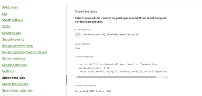

Now , I am using the serial number of the MX and the device ID as shown bellow, but I am getting 404 error code
url = "https://api.meraki.com/api/v1/devices/Q3KY-XXXX-XXXX/liveTools/speedTest/2345543333"
Create Device Live Tools Speed Test - Meraki Dashboard API v1 - Cisco Meraki Developer Hub
I think you need to read the speedtest endpoint documentation a bit more closely. To actually perform the speedtest you need to POST @ /devices/{{serial}}/liveTools/speedTest. This will perform the test, and return the results. Those results then get stored (tracked by a unique ID).
The query you have above is the query to retrieve the results of a previously run speedtest.
Edit: And note that this endpoint appears to only be available if you have the Early Access API enabled
