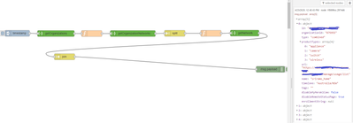

I tried to use the function called "Join" to join the outputs of "getnetworks" and get a complete output of single object. I am not sure if this is what you are looking for or if it is different with JSON. FWIW, please find the output of getnetworks, parsed through join below.
Worked well with JSON as well.

Hi Ipopejoy,

GetOrganizationNetworks returns multiple values for you, right?
That is right. It returns 5 networks.
Nice, you inspired me to revisit that option, and I found the issue!  🙂
In my case, I had an org that was disabled because they had closed the business, and that was causing an error and causing the JOIN node to not work correctly!
