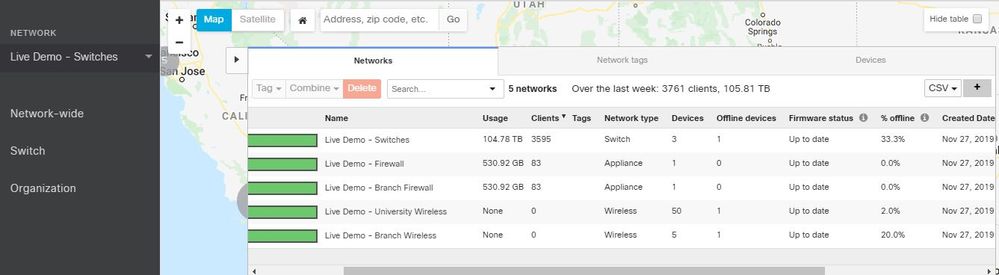

Hello,
Starting to explore how Meraki API works, so launched a meraki demo environment to test it.
Below are my network dashboard on demo environment
1. The data we need to fetch via API for each networks are  Devices, Firmware status & Offline devices etc
But when I used below API call, above needed infos are missing.
https://api.meraki.com/api/v0/organizations/<org-id>/networks/
You listed the Networks endpoint, which only gets info about networks, not devices. To get the devices in a network you want this:
https://api.meraki.com/api_docs#list-the-devices-in-a-network
But to get the status you will need this:
https://api.meraki.com/api_docs#list-the-status-of-every-meraki-device-in-the-organization
You can use the networkId field to collate these and get what you're after.
