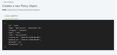

I am creating a script to move policy objects from one org to another but I am receiving this error {"errors":["The following required parameters are missing: 'name', 'category' and 'type'"]} I am able to move one policy object at a time successfully but I receive the error when moving multiple. I have added a sample of my json file below. I believe my issue is that "objects" is not the right syntax for posting multiple policy objects. I was  able to find documentation from the 1.8.0 beta changelog but it only shows an example for posting one policy object at a time. Any additional information is much appreciated.

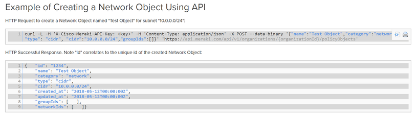

Inderdeep
@Austin_Campbell : This is what you see ?
Cisco Awarded Blogs 2020/2021 https://www.thenetworkdna.com/

I have seen the documentation you have listed above but the specific documentation I was referring to was this. I could not find this endpoint in postman or the python sdk I am guessing because it is in beta.
