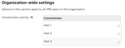

Is it the Hub / Concentrator priority you are looking to amend, i.e. the below area on the Dashboard UI? Only as we as a dev team were looking at this early last month for a few retail customers and there is very limited API coverage for MX Firewalls in VPN Concentrator / Passthrough mode, this one didn't have a support operation we found so made a feature request, it is also acknolegde by MX PM that there is limited API coverage for MX Firewalls in this mode. Be interesting to know which API endpoint you utilising like @BrandonD has mentioned 🙂
