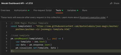

The API Get has a envirnoment with the APIKey and OrgID. It returns a 200 OK code. But the Log output is the "JSON Magic - Meraki Postman Visualizer", not the expected list of networks.

When you import the Meraki Postman collection it has a configured test for JSON Magic that is used to help visualize the results in tabular form.
What you can do to get around this is save the particular endpoints to a new folder to be used just for your flow so that it doesn't complicate the Postman Flow. Be sure to remember to add your API key (or environmental variable) into the settings for the new folder.
Alternatively, if you are fine without the options for visualizations you can just remove that from the tests from the Meraki collection folder.
Removing them from the tests worked!
