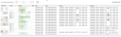

Since we don't have access yet to the address settings in the network template, this script will download the organization changelog.
Step 2:
It will download all templates and map all network configuration changes to the templates.
Which also means, that it can only detect networks of a template which got changed in the last 14 months or 2 years. see Meraki Documentation for details

You can extract the subnet settings from the dashboard changelog and use the latest one.
