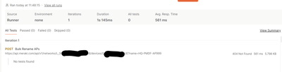

What I got is shown below:
so the output shows it has gone to the right network, picked up both the AP serial number and the new AP name from the CSV file OK, but is showing a 404, not found, and is not updating the AP name.
I think this may be because it needs to know old and new names, and can't find the new name in the network (hence the 404 error), which is correct, but I don't see how to make it search out the old name and swap it for the new.

I only dabble in API stuff and I literally did a runner for the first time time today, but I think you may be using an invalid/retired syntax.
Update device is now network (and organization) agnostic: https://developer.cisco.com/meraki/api-v1/update-device/
If you sync the latest api collection to your postman install you should see this API endpoint and be able to create a runner off of it with the CSV you have and be successful.

Yeah the post referenced was started back in 2018 and mentioned deprecated API endpoints. I haven't tried doing bulk editing with the new endpoints yet. But I agree a new endpoint would need to be used to get this working.
