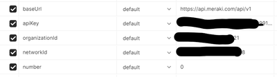

I’m trying to do a bulk rename of APs in Postman. I have Postman set up with the following variables
And they work, so if I do any of the following, I get the expected output

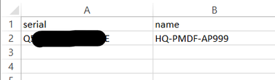

So now I want to use runner, so I created a CSV file called “name-change-data” with a header line and a single line relating to a single AP I want to test on
The serial number is the number seen in the Meraki Dashboard, so I know that is right, and the name is just a different string to what is there at the moment.

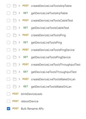

I then create a collection called “Bulk Rename APs” that looks like this:
{{baseUrl}}/networks/{{networkId}}/devices/{{serial}}

I then go to file>New Runner Tab, and get a window that asks me to “Drag a collection from the sidebar to run”, so I drag “Bulk Rename APs” in. It goes in with a lot of others, so I deselect all of them and reselect “Bulk Rename APs”

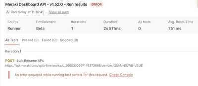

On the right of the page, I click “Select File” and select “name-change-data.csv” and then click the “run” button. I get the following result:
And the console shows
What am I doing wrong, and why is github flagged?
