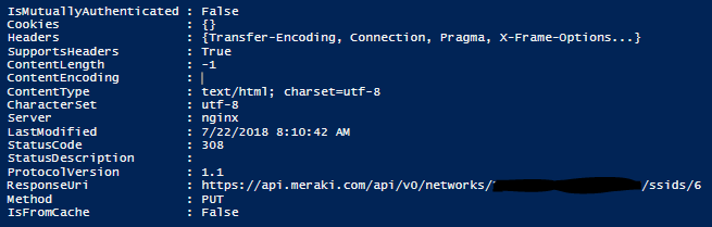

I tried capturing the response I get back using the below code:
$resp = try { Invoke-RestMethod -Method put -Uri $MerakiUrl -Headers $headers -Body $jbody } catch { $_.Exception.Response }
$resp
Here is the output of the above:
Any insight would great.
