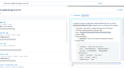

Out of curiosity, would you mind asking the AI-powered search in the documentation page how you might achieve this?
I wonder how you’d prompt it, and what would the response to that prompt be.
Mloraditch
Suffice it to say the AI needs some more time in class 🙂
When I was trying to help OP this morning, I just used regular search and that didn't help me find it either. Although I was more traditionally searching.
Oren
Meraki Employee All-Star
Thanks. Do you mind marking the thumb down icon and share the expected result, so the team can look into the thought process there?
(we're not getting replaced just yet 😉)
My personal feedback - I have not had any luck with the AI recommending workable or reasonable solutions.
