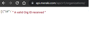

Then the queries would be simply :
 https://api.meraki.com/api/v1/organizations/   ( with a valid API key )
https://api.meraki.com/api/v1/organizations/{organizationId}/networks ( with a valid Org ID obtained from the previous call )
Simply log into any Org that you have a API key in your browser and paste the urls in the url bar :
This is how I test my calls before scripting.

So you are trying to Get https://api.meraki.com/api/v1/organizations/  which should return you a list of Orgs that you have access. Then you will be able to retrieve the ''id'' ( which is the OrgID ) and try https://api.meraki.com/api/v1/organizations/{organizationId}/networks  with the correct ID.
My favorite way to test these API calls , is by using Chrome and logging to the desired Org and then typing the API url in the url bar.
Wow! That was awesome. Thanks for sharing that. I got the results and the Organization was present. However, when I add the organizationId( or the organizationId/networks) I get a 404 error.
