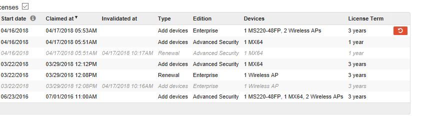

I should have the correct device count and corresponding licensing, but instead my "License Problem" page shows this.
Now here is the license history screenshot without the licenses included.
So what is my problem and how do I fix it?

Ah I see, It was because of one of the AP's was added as renewal. That sent my initial device count down to zero because it was waiting for corresponding licenses to renew the first batch of devices. I found out the hard way that Meraki does not support partial renewal of devices. You either have to remove the offending hardware or renew all devices at the same time. Meraki support has been very helpful and helped me understand my error! They fixed it up!

On the AP side, it looks like you started with 2x AP licenses (6/23/16) then did a renewal for just 1x AP (3/22/18). You've now added an additional 2x AP licenses (4/16/18) for a total of 3x.
For the MS side, because you didn't renew the original license (6/23/16) it looks like your count went to zero until you did the additional license on 4/16/18.
I think where you stand today is a need to get 2x additional AP licenses and 1x additional MS220-48FP licenses and add that as an "Add devices".

Why did the count go to zero? Was it because I added the hardware before adding the licenses?
Re: License Problem - 30 day grace period HELP!
