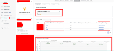

You can see the client(s) causing the dip in performance by going to Wireless > Access Points > Connections.

can you tell me how to solved this issue conection or reset alert issu on conection client ?
