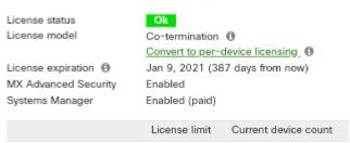

Depends on what you mean with proper. Let's have an example. If this is the co-termination date:

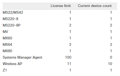

And this is the device table:
After conversion the number of per device licenses for each of the present product groups would be equal to the left column amounts. Then from those, a number of licenses would be attached to actual devices, namely the number in the right column.
Each of the new per device licenses would be valid for 387 days.
Effectively this means nothing has changed from a value perspective.

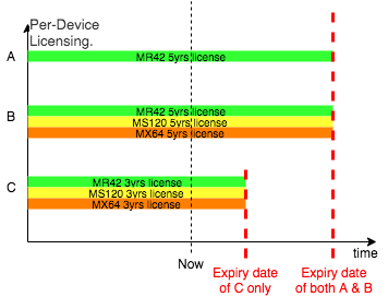

Dear BrechtSchamp,
Thank you for your answer! I'd like to understand this properly, please allow me to question this again.
Attached pics are my understanding for both Co-term & Per-Device. Is this correct?
In our network management policy, there should not be "C" example. So I would say each license for each network should be consumed "properly" for 5 years. My concern is that what will happen to my organization if there's "C" example actually(Unfortunately, I haven't been managing all purchase of licenses)
if my understanding as below pic is correct, it's okay for me though...
