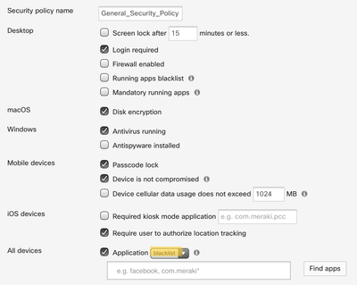

CptnCrnch
You could use Application blacklisting:

CptnCrnch
Application blacklist is part of a security policy. If some device will violate this policy, you could do (almost) whatever you want with it, e.g. deny network access.
