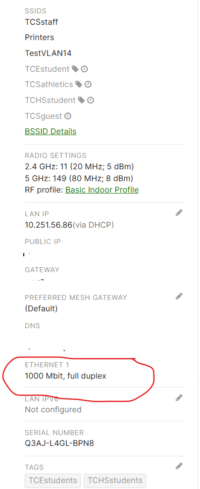

Hello, until recently, I have been able to see the CDP/LLDP information for each of my 53 Access Points. please see attached Picture- I used to be able to access a hyperlink just below the Ethernet 1 information.
Now I do not see anything about which Switch/Port my APs are connected to. I suspect this is browser related to our Google Admin and Chrome configuration, but I cannot confirm this.

Thanks! I opened a case with TAC and will post the results here.

I can confirm there is a recent known issue related to the CDP/LLDP information missing that is currently open.
I'm certain whomever is working the case you opened will determine if your issue is aligned with the known issue.

This issue seems to only be impacting LLDP connected devices. I have two APs in our organization connected to Cisco 3560s and 3850s and both of those APs correctly display the hyperlink and associated information under the AP Summary Page.
My Aps that are connected to HP Switches do not have the hyperlink.
