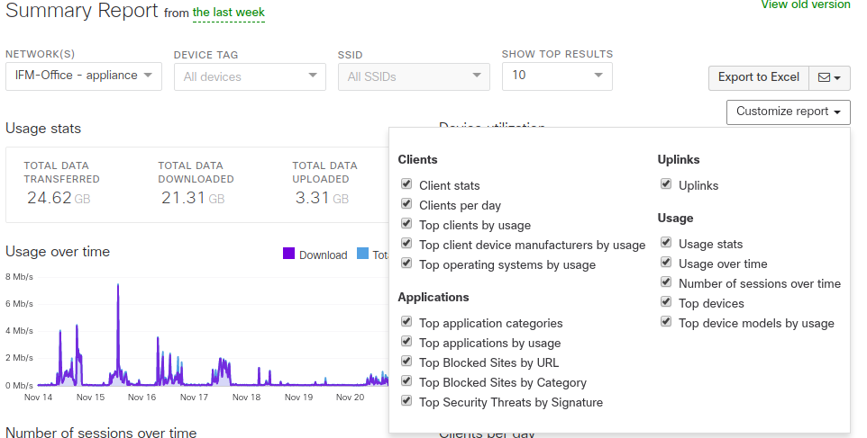

I assume we are talking about "Organisation/Summary Report".
Are you using the "new version"?  I think there is a link in the top right hand corner to change to this one.  Then you can click on "customize report" in the top right hand corner.  Note there is currently a bug where if the browser window is too narrow that the "customize report" button does not work.
