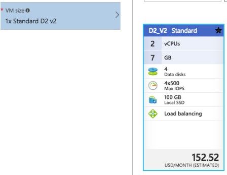

My question is regarding the correct vmsize/spec for vmx to work on Azure.
As per Meraki guide "vMX100 Setup Guide for Microsoft Azure", the size should be:
However, our presales team has purchased this
Questions:
  • Will the above spec work for vmx?
  • Where can I find recommendation for vmx vmsize?
You don't purchase a seperate machine (you can tell them to delete this).  It is all done as part of deploying the vMX.  During the deployment you can only choose two machine sizes, D2_V2 and D2_V3 (from memory).  D2_V3 is faster and cheaper, so I tend to use that.
