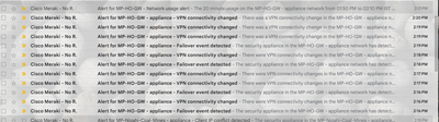

At day, Iam received continuously 3-4 times vpn connectivity change alert.
And that time, dns and services hosted on cloud that is connected through ip-sec tunnel is unreachable for 5-6 seconds.
This alert comes only during daytime, if there is any problem related to connectivity and power the alert should have come at night also.

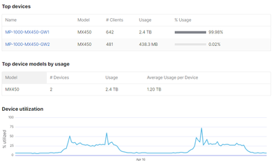

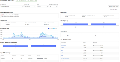

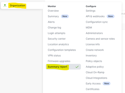

I have also seen this happen when the MX is overloaded.  You can see the load by going to Organization/Summary report.  Set the period to "1 day" at the top.  It is in the panel down the bottom left.
What model MX do you have, and how many users do you have?

Last day
There should be a panel in the bottom left-hand corner like this:
If you still don't see it, change the report from being for the whole organization to just the one network with the MX.

MX 450 in HA, Users around 500-650 including all devices

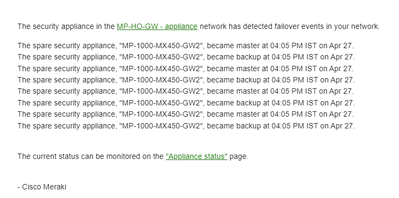

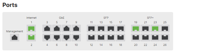

You are getting failover events that is causing the problem I believe.  This could be the SNORT engine or other crashing, or simply VRRP issues on the LAN side.  What devices are the LAN ports of the MXs connected to an how many links are there?  What version of MX code are you running?
Shubh3738
A model citizen
Current version: MX 18.107.2
Links- 2 ISP leased line Links.
Lan ports in MXs connected- Only core Switches that is also in HA.
