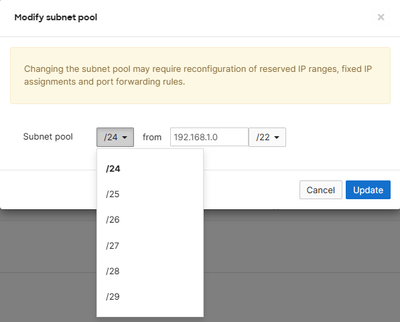

Note that the MG allows a maximum of a /24 to be configured:
https://documentation.meraki.com/MG/MG_Best_Practices/MG_Wireless_WAN_Dashboard_Settings

Thank you @PhilipDAth! The visual is very much appreciated!
