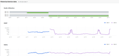

Yes, it was working fine for 2 days or so, then as you can see in the graph below there was an outage (not sure what cause was), then it swapped to SIM #2.  Now that SIM#2 is active, how do i remotely change it to SIM#1?
I had rebooted the router to see if it would swap back to the primary, but it stuck and is staying on the secondary...   Can i change the APN on SIM#2 to something invalid to force it back to SIM#1?
