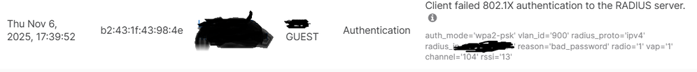

we r having failed connection for new users to Guest SSID with error Meraki Reason (Code 103) EAPoL
Avinashtrivedi
New here
In our company we are having failed connection for new users to Guest SSID with error Meraki Reason (Code 103) EAPoL for one location users reported right now ..its failing in authentication stage. old users are working find.. issue is only on new users using gust-wifi ..SSID-Guest..what could be reason . As NOC engineer how can I solve this...meraki-brazil.pngmeraki-1.png
10 Replies 10
What type of authentication are you using? WPA2 with PSK, 802.1x, Open with captive portal?
I'm asking because it seems to be using 802.1x, but it would be good to confirm.

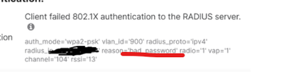

I believe the password the user is using is incorrect; see the error.
