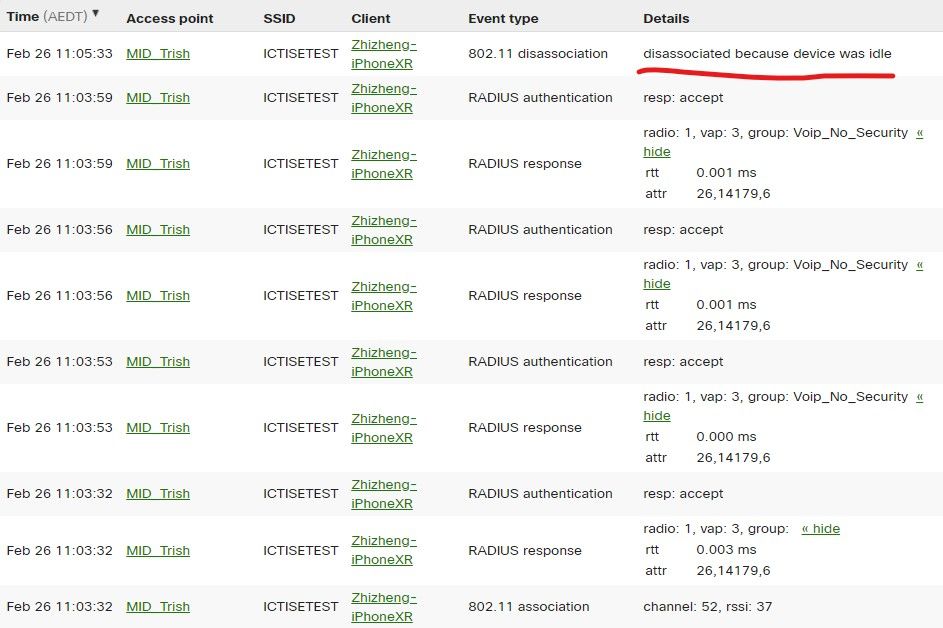

"disassociated because device was idle" AP event log
RichardChen1
MR33 with ISE (CWA)
https://documentation.meraki.com/MR/Encryption_and_Authentication/CWA_-_Central_Web_Authentication_w...
The redirection works, and after entering guest username/pw. I was able to get full network access.
However, the WIFI disconnected after a few minutes - it was my phone, so I lock it after testing.
This is the log I got from Meraki dashboard - "disassociated because device was idle".
Can't find any docomentation on this msg.
This issue doesn't apply to other SSID with just PSK, no 802.1x.
Question:
How/where to modify this idle setting?

I believe this is more of a client-side phenomenon related to power savings and cannot be controlled through AP configuration or the back-end adjustment of an idle timer.  Is this something that was working normally and then suddenly started doing this?  I've heard of some customers tweaking their DNS and/or DHCP settings with some success, but not sure if that could be related here.  Might be best to open a case with support and let them grab a packet capture (perhaps a monitor-mode packet capture) to see exactly which frames are exchanged prior to the idle disconnect.

I'm with @MerakiDave  - I believe this was sent from your device.  Your device said it was disconnecting because it was idle.  It could be related to battery level or a bunch of other factors.

I tested the same setup on a few Android and iPhone.
I was able to replicate the same issue on all iPhones but not Androids.
@PhilipDAth @MerakiDave I believe you are correct on this. Thank you.
