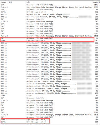

I can't exactly say what Reason 103 is, but according to StackExchange , it could have something to do with the re-keying process, where the client is sending an M2 with what the AP considers a MIC error. Reducing the EAPoL timeourt might do the trick.
RaphaelL
Makes sense that Meraki would re-use codes from Cisco's WLC.
Those '103' started to appear out of nowhere.
RaphaelL
I was able to capture it. I'm not an expert on that field at all. But it seems you were right with the M2. I can see a couple a 'retry' then finaly M2,M4 and the client is auth again :
Rollbacking to MR28.X fixes the issue. Weird. I will update my ticket
