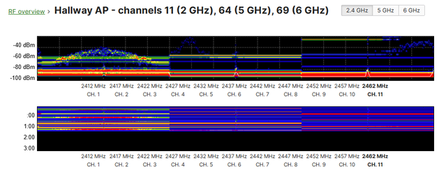

cmr
What AP model(s) is the user connecting to and what firmware are they running?
How many other clients are connected to the AP(s) the user is connecting to?
If you look at the RF Spectrum report for the AP(s) what do you see, here you can see the AP on channel 11 only has significant interference on channel 1, so is performing well:

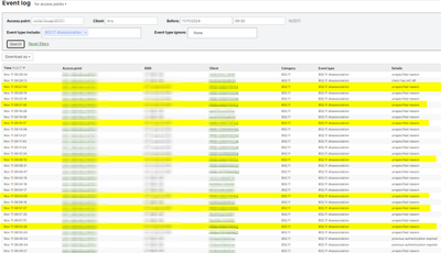

Investigator
Did you find the cause of your issue?
We are experiencing the same behaviour within our environment, we see clients frequently disconnect with unspecified reason even with stationary endpoints, they reconnect within 3 seconds.
We use Cisco Catalyst 9164 with the latest firmware 30.7.
It's always accompanied by this event in the WLAN report.
