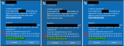

My issue is that as RADIUS runs inside access point certificate presented to client when they connect to WIFI is presented by access point.
Meraki has designed every access point to present it's own certificate (even if same SSID is used across all APs).
So when client connects to WIFI and then roams to coverage area of other access point then wireless stops working and user needs to log into WIFI again.

I do see this note. Question is how can I utilize the "current network" certificate name to overcome issue with roaming?
Flaw of the design is that although "Issued to" is the same across all APs the thumbprint of the certificate is different.
So when client connects to one AP and then roams wireless get's disconnected because client don't trust different certificate from new AP.
Ideal design would use same cert from all APs across the SSID.
