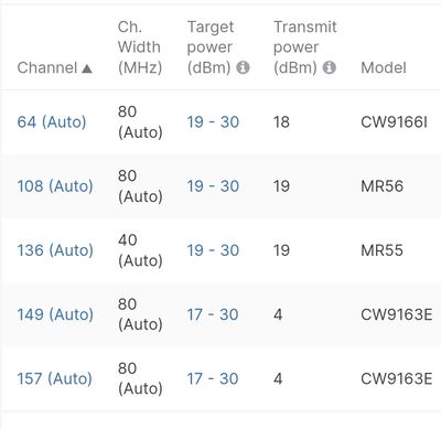

You can see here that some CW9163Es have picked an UNII3 channel, but the power is very low...
The UK allows 23dBm for UNII3 and one of those APs barely sees neighbours, so not sure why it is so low?
I have a hunch.. what happens if you bring your minimum target transmit power value down for the 9163E to say, 10 dBm?
@Paccers I have done this and will reply with results once the APs have had a bit of time to adjust.
No changes yet, but the two APs have different antennas:
top 9163 - CW-ANT-O1-NS omnidirectional dipole with 4/8/8 dB of gain
bottom 9163 - CW-ANT-D1-NS patch with 8/9/9 dB of gain
Therefore in UNII3 they should support 15dB and 14dB as a respective maximum. Were you thinking that changing the min to within the antennas range might help?
Interesting, my theory was a bit out there:
Theory:
Are these lab APs? The power ranges set on all of APs listed seem really high to me personally!
They are my home / test lab. The building has double skin brick walls and the total area is large so the APs are quite spread out.
I've also realised that in the UK, band C (UNII3) is only allowed to be used if you have a license and then only for fixed devices. The licence is easy to get and cheap, but I'm going to disable those channels for the outside until/if I get a license!
Changing to UNII2E (UK band B) only sets the power levels to what is expected considering the different antennas:
